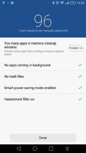

Thanks! Yes you're absolutely right. Everytime I optimize the mobile the smart mode for the battery is activated.
I've tweeted the issue to @HuaweiMobiles - I'll share what they come back with.
Is there some sort of Optimize button? If so, that's what you have to avoid. Huawei devices can be pretty aggressive when it comes to "optimization" and "boosting," so if you see notifications that you haven't "optimized" your phone in n days, just ignore it -- there shouldn't really be any need to "optimize" an Android device.
Ok - thanks! I regularly get notifications to optimise - I thought it was necessary - I'll ignore from now on in
