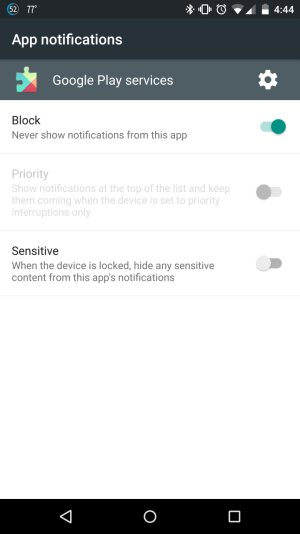

Re: OTA Updates while Rooted
Go to SETTINGS / SOUND & NOTIFICATION / APP NOTIFICATIONS / GOOGLE PLAY SERVICES
Then choose "never show notifications from this app".
The problem with blocking Play Service's notifications is that you end up blocking a lot more than an OTA notification.
The best way to block that I've seen is using a tool that can selectively block certain services from running. There are some flashable zips out there that probably do it. But you can also use a tool like Autostarts to go in and do a surgical strike on only the services that do the OTAs... looking around, here are the services:
