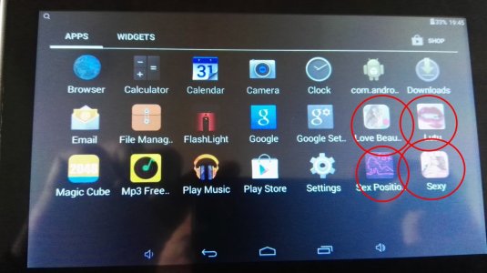

Cant get rid of unwanted apps that installed itself!
Recently a couple of unwanted porn apps / icons have appeared on my 7 year old daughter's tablet. I suspect it mustve been malware that installed itself? Anyway, I have been trying to uninstall them but no luck as there is no "uninstall" option for these unwanted apps, all it allows me to do is "Force stop" and "Disable" it. But that doesnt help it still launches. I've tried doing a factory reset, no luck. I also did a Safe Boot and tried to get rid of them in this mode but no option to uninstall them. Its really annoying.
Can anyone help me with advice on how to get rid of them? Or is there a way I can wipe the tablet clean completely?

Yeah when we first got the tablet i had to fill in wifi details, email etc. I've circled the unwanted apps on the pic. But there is also ones that are in the background called "com.softwinner.videotest", "DragonFire-v2.3", "Dragonphone", "bcfservice", "Magic Cube", "P*rnclub", "com.service.usbmoniter".... these are all still there. Infact I uninstall the first 3 and theyre back again after a reset via the recovery menu!?

Anyway, I did some searches on the names of the porn apps and came accross this on the XDA forums:
"I asked our resident hacker to take a look at the code himself, and he’s verified it does indeed root the user’s device via rageagainstthecage or exploid. But that’s just the tip of the iceberg: it does more than just yank IMEI and IMSI. There’s another APK hidden inside the code, and it steals nearly everything it can: product ID, model, partner (provider?), language, country, and userID. But that’s all child’s play; the true pièce de résistance is that it has the ability to download more code. In other words, there’s no way to know what the app does after it’s installed, and the possibilities are nearly endless"
So I think its becoming clear that these malicious apps have done the damage to my daughter's tablet and is stuck on it permanently! Really makes me angry!! :mad:
I now tried to put in my email etc and wifi so that i can install an antivirus but its popping up all sorts of ads and apps that wants to install!!! Madness!!!
Also when I go into Settings > Security > Device Administrators... there are 2 of the porn apps listed !!?? But I cant delete them. Frustrating.

The last few months i've been wrestling with my Android 5.1.1 tablet to get it to stop automatically, without my permission, downloading garbage apps eg. 9apps, Internet Browser, DU Battery. No matter what AV or AM program I installed, none could find the nasty on my tablet. I installed Droidwall and limited it to allowing internet access to frequently used apps like Instagram, Facebook, Play Store etc. Found that the offending program would create a Download/.info/cache folder to download these garbage apps into but didn't have the ability to get by Droidwall and grab the nasty apps. After deleting the offenders folders only to have them recreated again upon restart, I found it was a running process called "softwinner.loggerservice.". It also did not allow uninstallation and re-enabled itself if disabled, after restart. I was lucky that I had used KingRoot to gain root access earlier on and root access, strangely, remained after a factory reset. I then installed Titanium Backup and used it to uninstall the "loggerservice" program.

Good to know it was the same thing. I wasn't so sure because a few days after posting, another program automatically installed that bypassed Avira initially, but sent it crazy during a scan. Not the usual 9apps, DU Battery etc but called 'Search'. I also noticed regular pop ups leading to shopping and strange "Your phone has a virus" sites when opening the default browser and Firefox. After more research, reading many similar reports on other sites, that it could be an infected version of YouTube installed at the factory. I tried disabling it at first, but it kept popping up a "YouTube has stopped" alert repeatedly after a reboot that almost stopped me from using the tablet completely. I had to hit 'OK' then quickly tap 'settings > apps > disabled' between pop ups to re-enable it so the pop ups would stop. That sent up a red flag. I had to use Titanium again to uninstall YouTube because it was set up as an uninstallable system app. The browser pop ups have gone and now it's just a matter of waiting to see if this was also the cause of unwanted apps.
