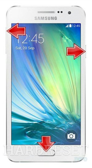

My galaxy a3 freezed and wont turn off.
How can i solve this.. i tried various ways to restart my A3 but it just wont cut it. It freezes when i try to auto rotate my screen, and it stay frozen. i tried the power button thing but it wont work..it stayed open and wont turn off.. please help ;/
press and hold together:*Volume Up*+Home**+*Power button, until you see Samsung logo.
Release held keys when Recovery Mode appears on the screen.
Select "Reboot System Now" using*Volume buttons*to navigate andPower button*to confirm.
Be sure not to hit the wipe data/factory reset by accident!!!

If the power button + volume up + home button doesn't work for you. Then try holding the volume down + power button! The second option worked for me. I was so terrified when it did coz it was stuck on a musical.ly video of a girl. LOL
Re: My galaxy a3 freezed and wont turn off.
True, press and hold volume down + power button for 7 seconds, locked or unlocked this will restart your phone. Works on many Samsung phones, including my Galaxy Alpha.
