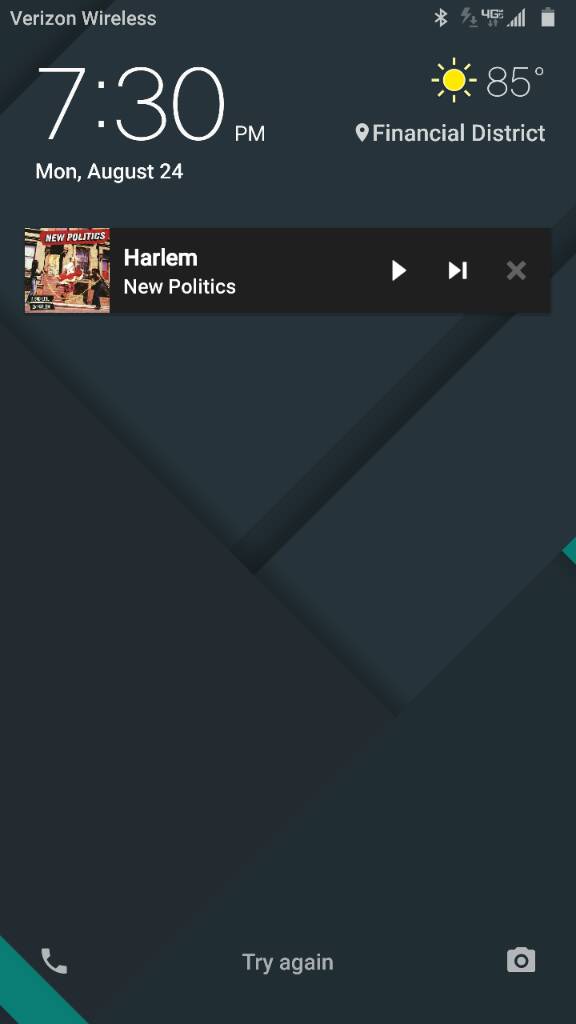

Are you using a 3rd party launcher? If so it may have its own lock screen setting? But if yer running stock or a launcher that doesn't have its own lock screen, then those instructions are correct. It should look like this.

No third party. Just stock. My settings screen looks like yours. Here is what I have. First screen show the slide to unlock and then the second screen has the fingerprint scan. The fingerprint scan does not work until I slide to unlock the first screen. I would like to hit the home button then scan my fingerprint right away to get to home screen. Right now I need to slide to unlock first.
I also have notification on lockscreen on if that matters.
