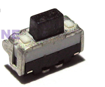

I bought some replacement switches off of ebay and tried to solder a replacement. Personally I don't know how anyone could replace such a switch. The contacts are surface mount which is annoying enough but the switch contacts are literally a fraction of a millimeter away from the switch casing and if you get solder on the contact and the casing you've shorted to ground and you're hosed.
Anyway, I failed to replace the switch and I'm pretty sure I've damaged the surface contacts in the process. I can't get the solder to stick at all. So power button isn't going to happen.

I found this thread by chance, I had a similar case. This thread is old, anyway, for whom may be useful, I tried to fix a lost switch, the kind you describe, I took it to a service shop and the technician told me that he could solder the switch but the switch could detach again, so, I found no sense in paying for the repair if it will not last, it's such an small piece, and minimal contact points, difficult to put it back to its original soldering strength.

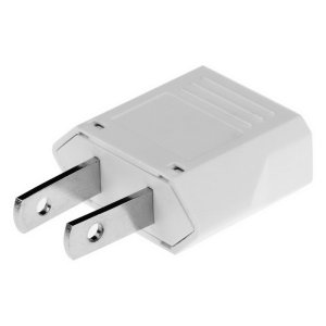

I found out that I could Turn it on with a metal piece, closing the circuit, bridging the bare soldering points left. Initially I used a paper clip with its two ends separated (I had to move it right and left until both contacts were touched, maybe tweezers could do the trick too), later I used another clip without modification, not bending and separating its ends, finally I found that an ac adapter flat metal contact worked well, and turned on the cell phone easily, I even could use it when on to bring up the menu to turn it off again, but I prefer to keep it on all the time and when I need to turn it off, my cell phone has a function in settings to schedule power on/off.
