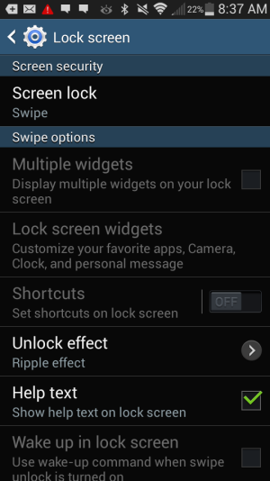

I have an s4mini and in Settings and Lock Screen the "multiple widgets" is grayed out, I can not select it and turn Camera shortcut ON in lockscreen. any thoughts why I can not enable this on my s4 mini but I can the s4?
See attached image, thank you.

That's really strange. I would just IM Samsung support on that one honestly.
Sent from my SAMSUNG-SGH-I337 using AC Forums mobile app
It's the same on mine I just figured that particular option was not available.

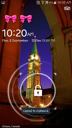

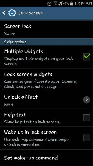

I did that changing the security thing but I still don't get the camera or widgets on my lock screen. Every time I swipe to the right, like I've read to do to edit the widges, it just unlocks my phone.

the same thing is happening with my samsung galaxy s4 mini, i have read that this happen when we update to Android 4.4.2, if you Find a way to correct it please let me know, i haven't found anything about it.
Yeah it's a kitkat thing.
If you're rooted you can easily fix it with a few different Xposed modules. Just scroll through the list of downloads in the Xposed framework until you find it (can't remember the name at the moment).
