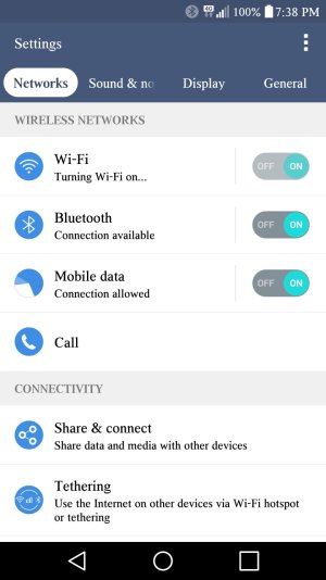

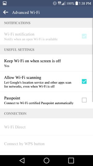

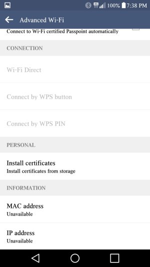

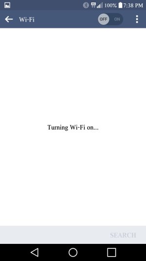

The WiFi used to cut in and out and was slower than 4g but then a month later, the WiFi decided to take a permanent vacation to lollipop island and now I cant turn any of the switches on or off. It's endlessly searching no matter where I am, so it's definitely the phone. Maybe these screenshots will help...
I know this is always a PITA, but if it was my phone, I'd do a factory reset. If that doesn't fix it, your wifi is broken, so your only option is to send it back to LG for warranty repair (I think it's about a 2 week turnaround). They're going to make you do the factory reset before they let you mail it in for service anyways, so you might as well do it before you even bother calling them. It may even fix the problem.

I had similar issue after reading about the location possibly searching i looked into my location setting and it was the issue. Scanning Wi-Fi for better location I turned it off and my scanning....ended. GL
