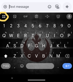

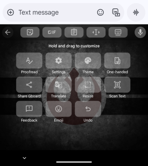

Welcome to Android Central! Can you show us a screenshot of what your keyboard looks like? If it looks like my screenshots, then try tapping the 4-square icon on the left of the top row, and see if the microphone icon is in the available buttons to add:

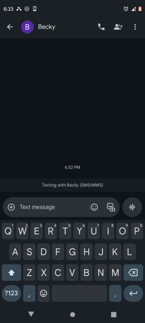

Sure. Here's my texting screen.

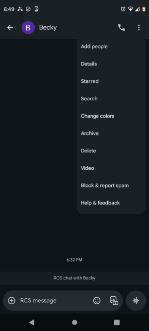

And here's when I touch the three dots,
1st streen was w/ SMS since wifi was off. 2nd was WIFI on. No difference - no mic.

Somehow your suggestions and voice input was disabled in GBoard (again, this is purely a Keyboard app issue, nothing to do with the messaging app). Since you can't access the Settings from the Keyboard, find "GBoard" in your app drawer and make sure 'Voice Typing' is enabled. Additionally check 'Text correction' if you want the suggestion bar to re-appear.
