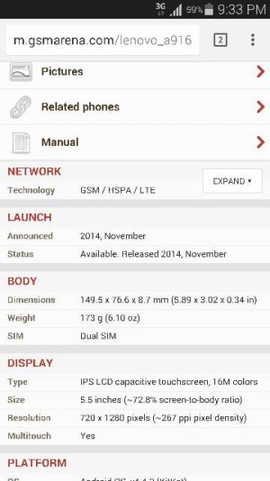

I actually found it to have 720p screen.

Your phone is a Lenovo a916, not a916c. Not exactly the same model. I evaluated both before buying mine and decided for the a916c because the seller specs said it had a higher resolution... :(
Re: unsure about display resolution
It was hard to find the detail but indeed the specs stated that the A916c variant has 1080p screen.
It was easy to identify qHD(540p) and FHD (1080p) at 5.5 inches display. Try look very very close on a tiny text at your phone. If it's slightly pixelated, qHD resolution seems likely. If not, it could be 1080p.

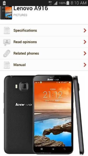

I'm not sure though. I don't even think your phone is genuine to be honest. I would bet that your phone doesn't even look like this. (Just a guess)
