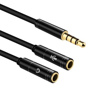

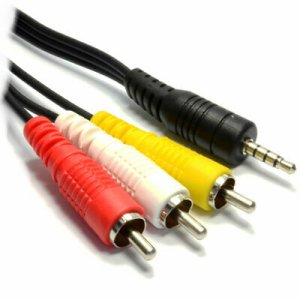

Buy a stereo phono to 3.5 TRRS jack which carries headphone AND MICROPHONE
Buy a 3.5 jack microphone splitter

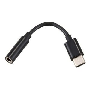

Buy a 3.5 jack to USB C

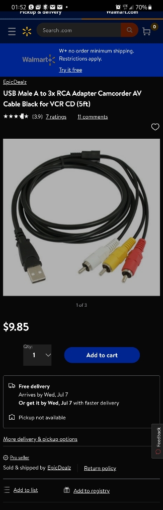

I found this with a quick shopping search... https://www.googleadservices.com/pa...iNmNeoycPxAhWSHM0KHRsBBlwQ9aACegQIARBL&adurl=
Alternatively there are other analog to digital products out there that do similar stuff. Depends on how much you want to spend. If you have an older PC they often have RCA inputs, most of the ones that don't still have AUX (microphone) type connections as do many laptops. I can usually find double male 3.5mm cables at my local Big Lots for $3 to $8.
Your link didn't show up -- can you edit the post or reply with the link?
Not sure why it wouldn't work for you but I've been there too. Anyway you can see the link landing in the image, it was only meant as starting point.
