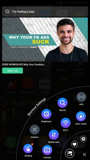

how to turn off bottom right corner pop out "shortcut quick settings" ?
Dear all,
i am using S6 and somehow or rather this bottom right corner keep popping out this half semi circle with all the quick settings tools.
it seems to be happens when i swipe up from the bottom right corner of the screen.
Possible to advise me how to close it please?
S6 new user
Re: how to turn off bottom right corner pop out "shortcut quick settings" ?
Hi, welcome to the forums! Could you post a screenshot so we can get a better idea of what's going on? Just in case, do you have Clean Master installed in your phone? This app has a feature called "iswipe" that opens a similar menu when you swipe from that corner. If so, disable it in the app settings or uninstall the whole app.
Other possibilities could be the Samsung Toolbox or some option that you have enabled in your accessibility settings.
I have this exact issue, I can't hit any bottom on the bottom right without this popping up, did you get an answer??

Uninstall Mobile Go App. That fixed it on mine

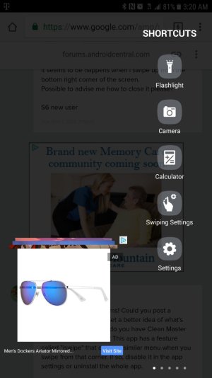

I have the same and I have a rooted S5 so I use Titanium backup and it has a feature called "freeze" which allows you to freeze an app. I froze ES Explorer and then tried to view the quarter circle and it didn't come up . Un froze the app and it eventually came back so ES Explorer is the culprit.
Hello,
Yes this is from es explorer, if u want to disable it go to es explorer menu (left menu) tap on ES Swipe and turn it off.
That's it.
I have a Samsung Galaxy J7 V.. so I don't know if it's the same for all cells..
I just had this problem & it is connected to the 'Photo Editor' app..
Here's what to do..
Open Photo Editor app..
Touch the 3 dots in the upper right corner..
Choose settings..
Choose 'Swipe' ..
Turn off 'Enable Swipe'..
That's it.. the annoying corner pop up settings should be gone.
I have the Galaxy S8 plus and have this problem with the half circle thing in corner popping up, cannot figure out on this phone where to go to get rid of it, any help would be appreciated, also do not have any of things listed above
Samsung S8, same thingy half circle lower lect corner pops up after swiping ( or just touching) lower left edge. Allow it to open, locate icon "swipe settings", select, select " turn off swipe" (or something along those linse) and the "crap" will stop. Initiated by somethi g in FB. Havent foumd what just yet.

In ES File Explorer, tap the 3 little horizoltal bars at the upper left,
select ES Swipe, then slide the ON slider to the Left to Disable It. Fixed.

I have just got that pop up thing off my s6,i figured out it was from a post on fb ,about making frames and collages for photos....i went into my google photos and found it and turned everything off...pop up is now gone thank god....
Its just a really dumb update and hace no idea why they made it aside from the ad revenue?
