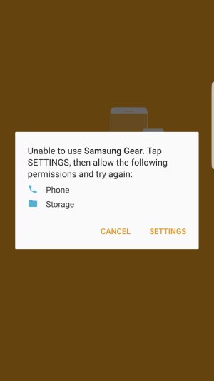

I was having trouble pairing my Gear S2 Classic Watch to my new Note 7. The screen overlay error prevented me from pairing the Watch.
I turned on the Developer Options (see instructions below), restarted the phone and it problem solved. Screenshot_20160826-100341.jpg .
