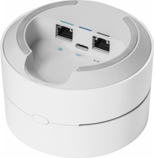

So that brings me to my question... are the 2nd and 3rd Google Wi-Fi devices also able to be hardwired to the network... as in passing network traffic from clients back to the primary AP/Router over the ethernet cable. I know there's a couple network ports on them but are they just for clients to connect to or can you connect back to the primary AP/Router with it too.

Found this image on the Best Buy website (currently having a Black Friday sale [along with other retailers]). Looks like there is a WAN port and LAN port (check the different Icons).

"If I have wired Ethernet throughout my house, can I physically plug in each unit to the network and have them function as one mesh wifi this way?"
Answer
"If you hardwire the units, you will still get a single Wi-Fi network throughout your house. The points will use Ethernet for connectivity between the points. "

A couple months ago I pick up a 3 pack of Google Wi-Fi and so far they have been great. You can definitely hardware each of these units. There is no setting changes required to hardware them, it will automatically detect whether you are hardwared or not. Although you will need to initially set them up using wireless... I recommend you have them next to each other for the initial setup, then once setup put them where you want them and plug in the network cables.
