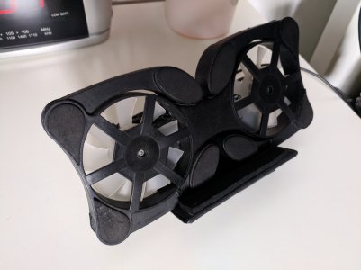

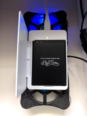

External battery charger plus a cooling fan = effective safe charging at low temps which means better longevity. High heat damages the battery overtime... learned that the hard way with wireless charging on my S6 Active.
BTW these are laptop cooling pads from eBay, keeps the phone/battery cool while charging.
The LG battery cradle charger (the external one you have) doesn't heat the battery materially while charging. Then again it's not real fast, and while I have yet to stick a data logger on it for voltage I'd take a bet it plays more to-the-rules than the phone does.
