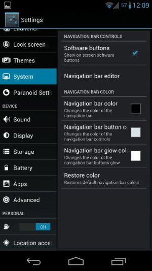

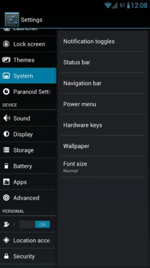

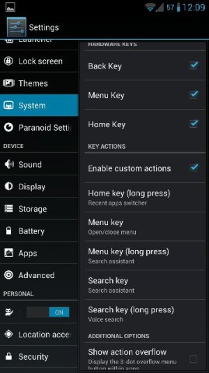

Just so you guys know, Paranoid Android (the P in the PACman rom) includes it under the settings as well. Its as simple as checking a box. You then have the option for custom colors, additional actions, etc. You can also disable or change functions of the hardware keys, as well as disable the key backlight.
Here are some screenshots to give you guys an idea:
