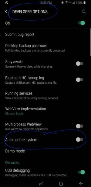

Also, there's a toggle in developer options called "Auto update system" that can be turned off to prevent being nagged to update. Working well for me so far. Or, one can always invest in Package disabler pro to disable system updates.
