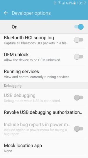

Unfortunately for me I still cannot access USB Debugging mode, it's always greyed!
Any help would be welcome

Could it be it has something to do with "my Knox"? Did you install it?

so simple. the reason why you had gray scale in usb debugging after enabling the developer mode, its because of myknox. i have encountered the same problem but i able to fix it. to fix your problem just follow my instructions.
1. go to https://my.samsungknox.com (use laptop or pc)
2. login your account by entering the email and password you had registered in your samsung account phone.
3. a several option will appear. just click UNLOCK and UNREGISTERED your phone option. then your myknox will automatically uninstalled in your phone. (make sure your phone has a connection)
4. go back to developer option after myknox has been removed automatically, then you can enabled the usb debugging now.
thats it. i fix mine. 100%. dont forget to say thanks once you fixed yours. have a nice day.

This procedure did not rectify the situation. USB Debugging is still grey on my S7 Edge Developers Options scree
Thanks gjavv! I just ran into this today and this was the first thing I tried. Saved me a ton of searching. +100 internet points
Very easy !! Its because that you installed the Knox app !!
Just uninstall the app My Knox ! And you r done !!
Is there a way, to fix this problem with out removing Knox?
I use Knox to give an extra security layer to my banking apps. And so do not want to remove that layer.
Bencleric many thanks for the suggestion. However, after several failed attempt to login online on my PC, I decided to just do that with my Samsung GS7 then was able to uninstall My Knox via the Application manager of the phone then restarted the GS7 to be able to enable USB Debugging successfully.
