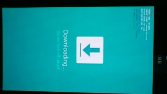

If you are just in the recovery menu itself you would just use the volume up and down buttons to choose "Reboot System No" top option and click your power button.
Or does your screen currently say "Downloading...Do not turn off Target"
If that is the case. I had this happen to my Mother In Laws S6, just about pooped my pants!
Hold down the VOLUME DOWN + POWER + HOME BUTTON you will have to hold it for 10 to 12 seconds, so be patient, until you see the phone turn off. Then let go and reboot
That should do it.
Let me know if that works

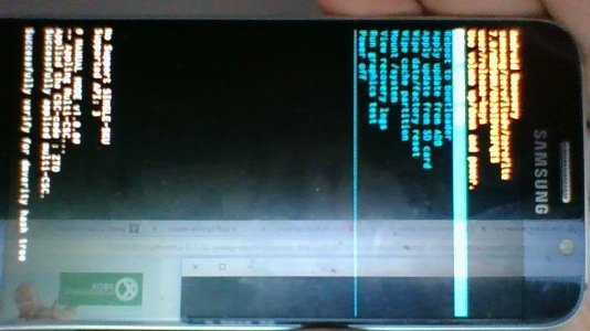

I was at this screen
After i did this procedure it came to this screen
And it doesn't go to my "home page"..
I don't want to lose all my files because i don't have a backup...
What should i do?
Thank you ;)
What should i do?
Thank you ;)
Just hit "Reboot System Now"
Hopefully everything is there, should be, but if not there's not much you can do at this point if it's not.
But when this happened to my mother in law, everything was there after the fact and it's the exact same situation
