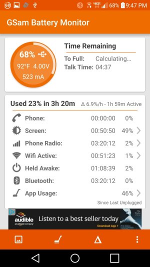

I had to put the phone on the charger this afternoon or it was going to die, so this isn't a good log of typical battery use. But it's the best I have at the moment, if it's of any value. I didn't get the charge all the way to 100%, either.

This is my GSam log from today. I took it off the charger (100%) at 7:30 this morning. I had 1:54 of SOT, with 1:47 of WiFi. I was backing up some data over WiFi, prepping for returning the phone. By 4PM (8:30 later), I was down to 21%. I'm not impressed by that, getting that low makes me nervous, and that wasn't even at the end of the day.
The WiFi use did definitely warm up the phone, but I would offer that today's use seemed pretty moderate to me. The only possible exception would be the WiFi, but even that doesn't seem unreasonable. See attached screenshots for the main view, and the breakdown of app usage.
