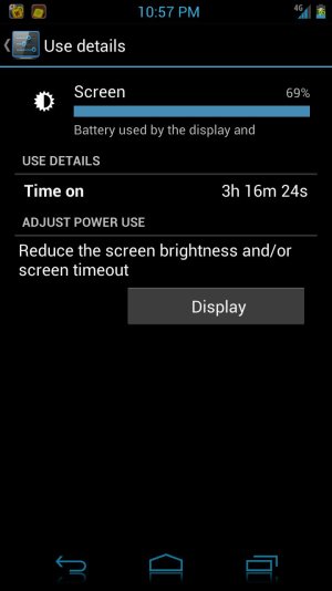

Just had to share this cause I've never gone much over 2 hrs screen time, but with this combo.....
Sent from my Galaxy Nexus using Xparent Blue Tapatalk 2
I got these results
