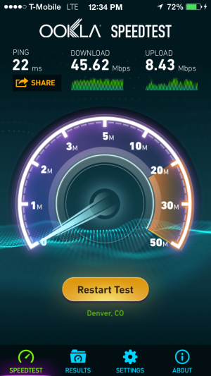

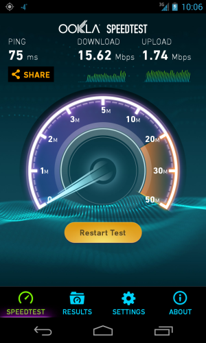

How do you explain my low pings on two different phones on T-Mobile? Most people get these low pings from what I can tell.
