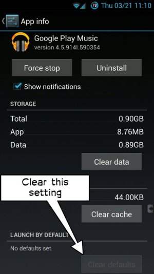

Normally, when you first perform an action, like plugging in the headphones, you'll get a prompt to choose the app that you want to be associated with that action. If there's more than one app that has that capability, you'll get a list and when you select one you'll also have to choose between "Always" or "Just once". Obviously, if you choose "Always" you won't be prompted again. It sounds like that's what's happened in this case. If you go into the Apps list and find the Samsung Music App, you can check to see if it's set as the default, and if so you can clear it and then the next time you can choose from whatever pops up in the list.uploadfromtaptalk1363890114527.jpgSent from my rooted, debloated, deodexed Sinclair ZX-80 running CM -0.001 using Tapatalk 2

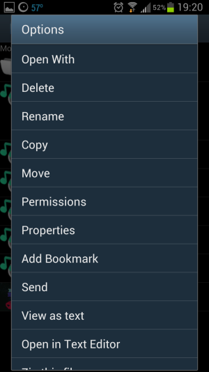

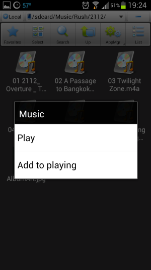

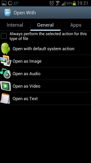

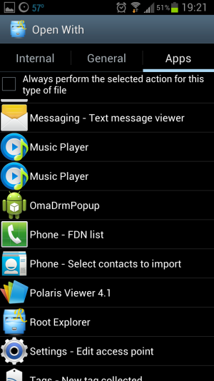

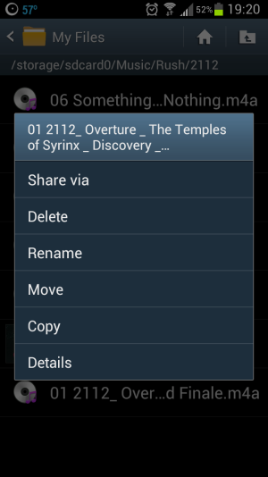

I have CleanROM which I think is close enough to stock. Same situation for the stock Music Player as Macbook5 noted. I double checked to see if I had frozen it with Titanium Backup, but have not. No option to set or clear defaults.
As GSDer suggests, I tried to select a media file from a few File Managers. The 1st I tried is the stock My Files. The 2nd is Root Explorer (images 2-4), which provides a nice "Open With" function. Interestingly enough, Rocket Media Player is what I'm currently using, and its not shown as an option, while the stock Music Player is. The 3rd option was ES File Explorer, which as expected provides an option to play via its built in player.
