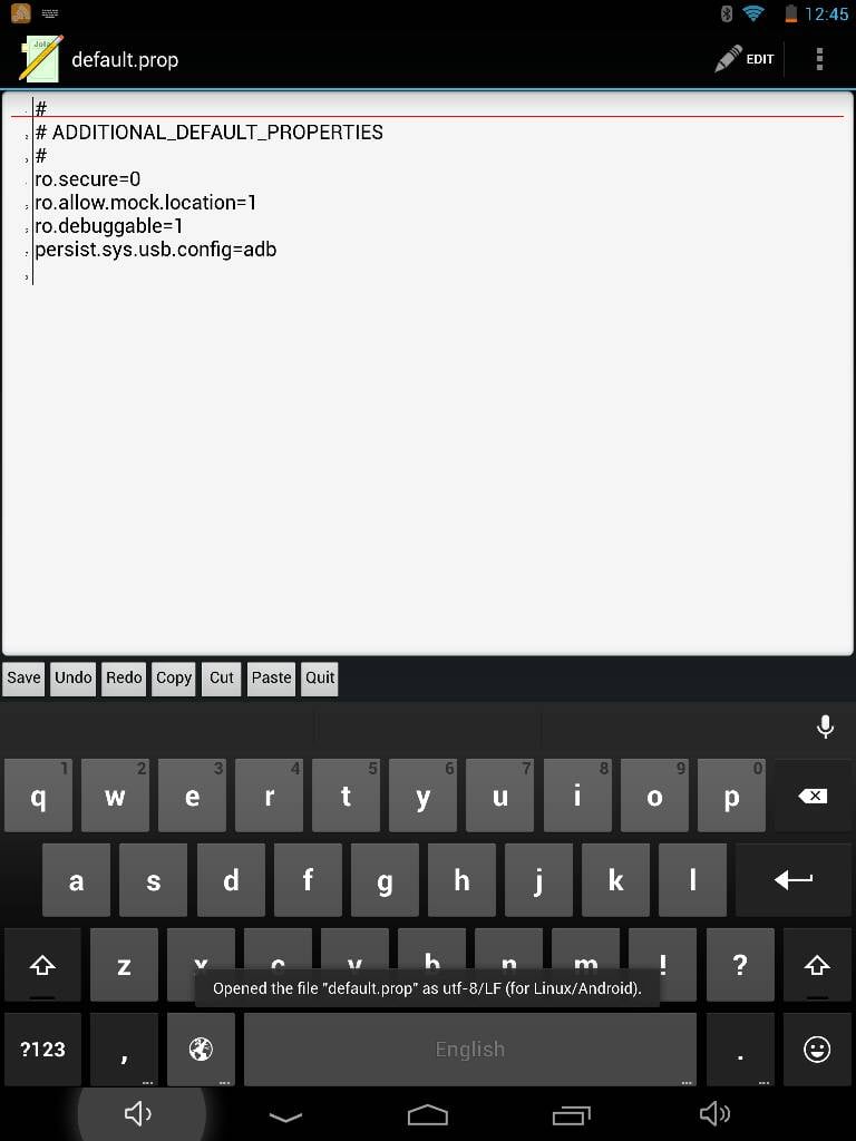

Here's my output of default.prop (I not modified it, because there is no * symbol after file name):
Sent from my eSTAR CRYSTAL using Tapatalk
So, there's root access on ADB-only! How I can execute ro.secure=0 in default.prop (not modified) via another way (excluding ADB)?
