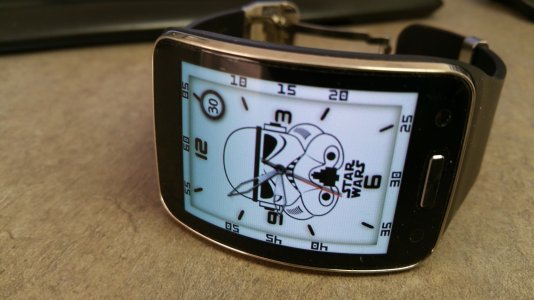

Yes you can, you need to download the face you want, then move it onto the phone, I just make a folder for them and copy them into the folder using your PC and cable. then open watch styler and select the "load theme" option. Hit "my files" and select the face you want, then hit "load" at the bottom right. once the face is loaded you can select it, and then at the bottom hit apply. once it is applied you can select the watch styler as your face in the gear manager and it will load to your watch. sometimes to get them to load onto the watch you need to change the face to a default one and then back to the watch styler. Hope that helps.
