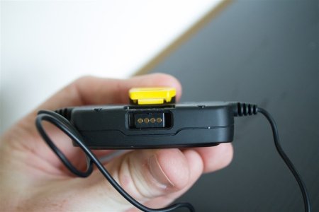

My 2nd question: There are four contacts on the bottom of the MP3 player. How do I map each one to know what is positive, negative, ground and data transfer? (Photo of pins attached)

With a connection like the one shown your best results will be to find the proper mating connector to wire up. On the up-side, if you can find the connector it may have matching wire colors to those found in a standard USB cable so it may be easier.
You'd need to find a schematic of the device (maybe on an FCC filing?) that details the pin mappings for that connector.
You have to find a mating connector - if it's USB (it may not be - 4 pins doesn't automatically mean USB), but the Duo charging cable may work (the picture is more detailed than your picture if you roll over it with your mouse cursor - take a look). It's US$20 (plus shipping), which isn't bad for a proprietary cable. Or contact Finis at:

Or submit a support ticket at https://www.finisswim.com/contact-us, asking how you can get a charging cable for the Neptune if the Duo cable won't work with the Neptune.
