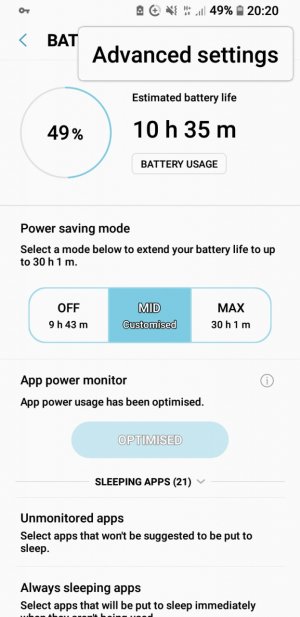

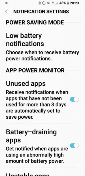

If you find the battery app on your settings, you should have the three dots in top right corner. Tapping those should give you advanced settings. There you should have notifications....

Your suggestions do not work. The three dots do not give advanced settings.

And this
