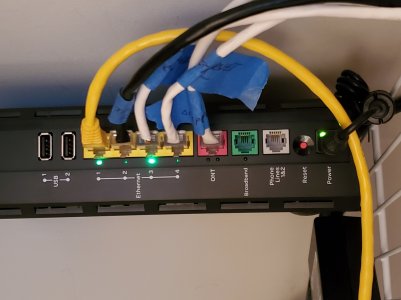

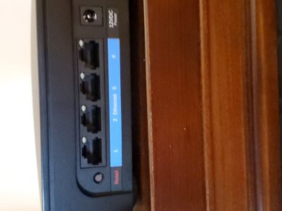

This Booster has all Ethernet outlets.No problem. I don't know where to plug into the Router.

You haven't provided any information at all about what equipment those two pictures are of.
Since the second pictures shows an ethernet cable going to ONT, I am going to guess you're in a FIOS area served by optical fiber to the house. There is an "ONT" (optical network terminal) in such a service, which converts optical to electronic/ethernet. Same purpose as when service comes in via coaxial and goes to a cable modem, again getting converted from coax to electronic/ethernet. In that case I suspect you would have seen an ethernet cable instead going into the "Broadband" socket on this box. Both ONT and Broadband are, in my opinion, the WAN connectors to upstream outside Internet.
So those two connectors are the upstream WAN connections to the outside internet. And the internal 1-4 ethernet downstream LAN connectors go to 1-4 assorted locations around your house, probably in 2-socket or 3-socket wall plates that perhaps provide sockets or coax screw-on connectors for telephone and/or coaxial cable (for the FIOS TV STB/DVR) and/or ethernet. If you need more than four remote locations you can insert "wired switches" (e.g. Netgear GS105 or GS108) which provide multiple output ethernet ports from a single input ethernet cable). The switches get connected at the remote wall plate locations around your house, thus providing 1-8 wired ethernet output connectors from only 1 ethernet input cable.
Note that if you want remote wireless capability improved in the old fashioned simple way you also can use a "wireless access point (WAP)" plugged into the wall plate. For example Netgear WAC104 or "any router set to run in access point mode", which will provide four wired ethernet sockets (like a 4-port switch) as well as a separate WiFi network radiated by the WAP or router running in "access point mode". But if you use this apprach, then each of the WAP/router-in-access-point-mode setups radiates its own unique wireless network id. The advantage of the "mesh network" approach is that you only have one single wireless network name to connect to all throughout your house, no matter where you're standing.
I am guessing that FIOS box is perhaps installed in your basement or network closet where all of the outside electronic services get delivered to your house, and where all of the FIOS equipment has been installed onto the wall. That's where it all starts for your home, from the ONT into this wifi/router box, and then the four output ethernet cable runs to the far reaches of your house. And no doubt the wireless capability of this wifi/router is just not strong enough to deliver wifi adequately up one or two or three floors of your house and to the far reaches you need it in.
So, as I suggested, you get one of the products I mentioned, either Eero or Amplifi HD. Because you already have a router from FIOS, you will be installing the Erro/Amplifi equpiment in BRIDGE MODE. This eliminates the "router" functionality of their system, and only implements the "mesh network" WiFi functionality. Thus their equipment is working much as the "wired switch" does, except that instead of offering 1-8 ethernet output ports from 1 ethernet input cable for devices connectable via ethernet cable to the switch, it offers any number of wireless connections all throughout the house through the 3-device "mesh wireless" network.
So, pick one room at one end of the house where there is a wall plate connected to one of those four cables running down to the FIOS box in the basement. That will be the "base station" unit for Eero/Amplifi. Remember you need to go with the "bridge mode" approach, to disable the router functionality and facilitate their equipment strictly as a "wireless access point" connecting to the FIOS router in the basement for all DHCP IP address assignment to all wired and wireless connected devices. Connecting the "base station" through one of the LAN ports on the FIOS router is what "bridge mode" installation means, as opposed to the other normal setup where the "base station" gets plugged directly into cable modem (i.e. there is no cable company router at all) and the Eero/Amplifi boxes serve as your wired/wireless router.
Then you can set up the other two boxes of the 3-device "mesh network" at other rooms in your house (e.g. mid-point and far away), same as if you'd connected the "base station" right next to a cable modem for normal setups.
