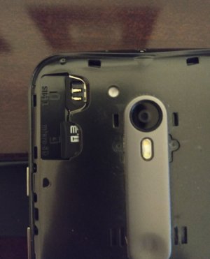

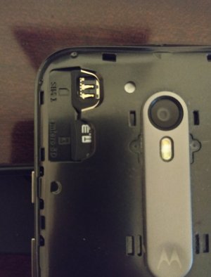

Thanks for the tip, it won't let me edit my original post (I think because I posted it without an account), but the photos are below.
The SIM card slot is the one in the top left hand corner. The adaptor/tray has got stuck in the SIM slot, without any SIM card in the adaptor.
The first 2 photos show how much (well, how little!) I can move the SIM adaptor out easily (about 1/5th of the way), before I encounter a lot of resistance & it seems to get stuck.

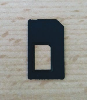

The bottom photo shows an example of how the adaptor/tray looks; note that the the one in the photo is not the same as the one that's stuck, and is too big to fit in the the slot.
Have you tried pushing it in further?
Hi, yes but it won't go in any further than the 1st photo (the 2 photos show the full range of movement that I can get, before encountering resistance).
Though when trying to push it in further, it feels more like it's reached "the wall", whereas in pulling it out, it's more like it's got stuck on something/trapped.
To be honest at this point I doubt you have much to lose by pulling it out at any cost, if you can't get it out your phone will be useless.
I think there's a good chance you'll damage the contacts by pulling it out. Can you ease something very thin under it, between the adaptor and the contacts, to keep them pressed down when trying to withdraw?
Many thanks, this has worked.
Though my adaptor did come out slightly warped (I think from trying to pull it out in the past), so can't fit a SIM card into it now, to check if the contacts are damaged or not
For anyone else having this problem, I'd recommend watching this video - https://youtu.be/3vrntitwm1U
You want something thin, but rigid enough to slide underneath without crumbling; I didn't have plastic, but I used a thin piece of card, which was just about rigid enough
