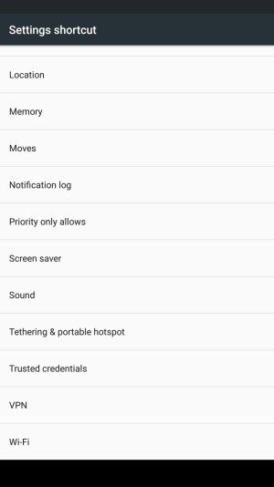

This works on a Nexus (with the Google launcher), try it on your device, but it may not work.
Long-press a blank area of the home screen, select to add a widget. Scroll through the widgets until you find the Settings widget, long-press that and drag it to your home screen. This should then pop up a list of settings you can add, one would be the Notification Log.
Here is what you get:
Don't have Settings as a widget on my S8+. Verizon may have removed it, not sure about other carriers.
Yeah, most Samsung devices don't include that widget. You can always try with Nova launcher and search for the notification log under widgets - Nova Activities.
