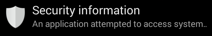

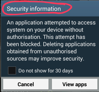

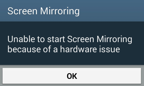

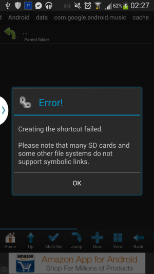

I am stuck here. I have recently upgraded the stock rom of my Note 2 to leaked Android 4.3 JB. And below is the error message that I continuously get when I am trying to create a shortcut of a cache folder from my external sd card to Note 2's internal SD card using ROM Toolbox. I did not experience this problem or issue when I did the same using the Stock ROM.
Please can you point or guide me in the right direction.
Also Continuous Input/Swype and AllShare Cast/Mirror to my Samsung AllShare Cast dongle/hub (connected to my TV) has stopped working too since this upgrade.
Please see the attached pics for more information.
Many thanks.
Many thanks.
View attachment 86884View attachment 86886View attachment 86888
Sadly, I have no clue what the issue is. The best I can do is recommend some intense Googling.
