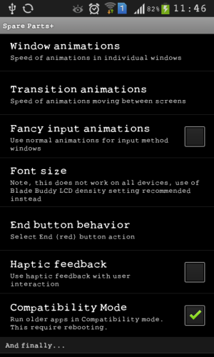

search and download spare parts plus application from playstore. unckeck haptic feed back there in option Screenshot_2013-10-04-11-46-28.png
After updating jeally bean there is no option i found to desable it so you guys can use this application to disable vibration on screen lock. it works :cool:
