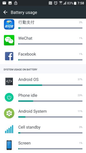

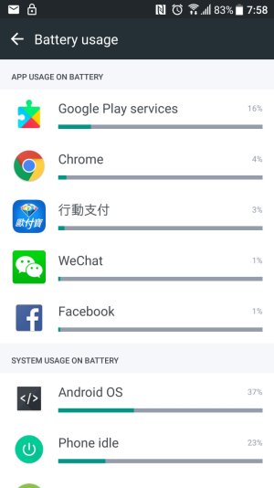

I post 2 snapshots to share my battery status.
The battery was full charged when I went to bed. When I waked up it became only 83%. Most battery consumers are Google play service, Android OS, Phone idle ("! why phone idle needs to consume battery ??") and Android system. I did not active any apps when I went to bed, not sure why they consume my battery that much...
