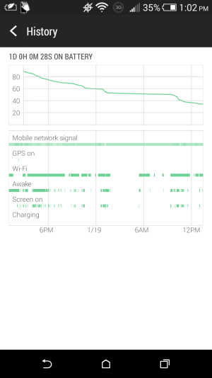

Well here are the shots you asked for. I could only find this one. I don't know what happened, but the battery lasted a long time this time around. Keep in mind I was hardly using it all this last 24 hours. I also wanted to ask if anyone knew a good program to wake up the phone without using the power key.

When you tap Settings>Battery, you should see a smaller version of that graph, and a list of apps below it with the percent of battery that they've used so far. That screen is what I mean by #1. Within that list, tap Screen, and then show us that screen, which will say how long the screen has been on in total.

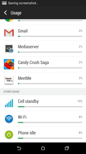

Here is the screenshots you wanted. Screen is not listed. Don't know where to find that one. Still thinking about taking this phone back in favor of the iPhone. It would be very helpful if I could completely remove the HTC Blinkfeed or disable it. I don't use it, and have it turned off in settings, but it still runs in the background and a force stop does not work on it.
That's strange--Screen is usually one of the top battery users. I wonder if it's in a different part of your Battery stats on that particular phone. I don't currently have access to my wife's HTC One, which probably has more or less the same menu, so I'll see if I can check that later.

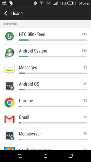

@kona0197 - I just got an HTC Desire 816, and I was very interested in your messages. I think that I may know why you got such a high reading for HTC BlinkFeed. My guess is that that percentage (14%) includes time before you turned it off. I say that because my HTC Settings --> Power also reports an HTC BlinkFeed percentage of 14%, but when I look at the figures from the app GSam Battery Monitor (which I added first to my Nexus 7 tablet and then to my HTC phone), it reports that the apps on the phone used 19.2% in the last 15h 47m 44s, and that of that 19.2%, HTC BlinkFeed contributed 0.5%. Since I turned BlinkFeed off sometime yesterday evening, that seems much more reasonable than the 14% figure I got under Settings --> Power. I'm assuming that that 14% is heavily influenced by the usage before I turned off BlinkFeed. At least, I hope so! :) [It looks as if I'm wrong. :( I'll post another message explaining this.]
While I'm writing, I thought I'd ask whether you (or anyone else) knows what the icon is at the top of your screenshot to the left of the WiFi icon.
Well, now that I've had my HTC Desire 816 for a couple more days, I'm beginning to see that I was probably mistaken in what I said about BlinkFeed. I'm afraid it's every bit the battery drain that koan0197 claimed, and it looks as if it can't be removed or disabled. When I've tried either force stop or other ways to turn it off, I find that all my apps disappear from my home screen (presumably because they're considered to be part of BlinkFeed), and BlinkFeed continues to make heavier use of the battery than any other app. I HATE BLINKFEED! And I hate HTC for not giving me some say as to whether or not I want to use it. I think this will be not only my first HTC phone but also my last. :mad:
