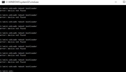

omg !!!! i finally did it guys ^v^ my phone is htc one max and it was stuck on cyanogenmod logo, i had a broken volume-down button, and i couldn't find any access to recovery or bootloader at alllllll
the method is simple and 100% garanteed :
1- install pdanet http: //pdanet .co/a/
2- install htc drivers http: //www .htc .com/us/support/software/htc-sync-manager.aspx
3- download mini-sdk https ://www .androidfilehost .com/?fid=23329332407580571
now lets get to work :
1- plug in your htc device via usb cable to pc and press the power button
2- wait until pdanet program gives you a sign saying " new device is connected"
3- open command prompt from inside the mini sdk folder by holding shift key and right click and choose "open command windows here"
4- type the command "adb reboot bootloader" and as you can see from the photo below the first time you type it might not respond so type it couple times more until your device restart automatically and then quickly press all the button of the device " touch buttons- back - menu - volume up" and voila !!!!! you are inside the bootloader menu
Don't forget to share this method with other guys
thanx from the Islamic State
I spent sleepless night trying to unbrick my HTC, only to stumble on your post and my problem was solved in less than 30 minutes.
thanks alot.
