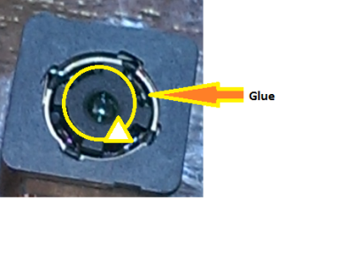

Final solution, You must dissasembly the smartphone, remove carefully the glue in camera, focus.png .
Then with a tweezer you must adjust the focus manually (as in webcams), until you get sharp picture, turn it clockwise first then adjust, maybe it works on other smartphones too.
Final solution, You must dissasembly the smartphone, remove carefully the glue in camera, View attachment 216731 .
I don't understand. How is forcing it to focus going to make it behave properly after you put it back together if it was malfunctioning in AUTO focus? Won't it AUTO malfunction again? What exactly does your solution do to stop it from misbehaving?
