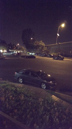

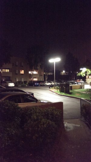

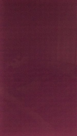

Hello,
I took some photos in darkness to show what kind of issues I'm having with my HTC One camera. I'm wondering if this is normal for most people with the HTC One or if I should get it replaced.
The two very low light images are taken in auto mode and the one with the red/major grain is taken with night mode. The photos taken outside are taken with auto/normal mode and give me a blue kinda grain on some of them. The photo of my Husky in my bedroom was taken in low light and gives a red grainy tint.
Is this normal for most HTC One users with low light pictures?

I am having the exact same issue. I get the reddish tint, with a huge amount of noise (interference) in the picture. So much so, that if I keep it on while in this manner, it will sometimes crash the camera app. On pictures with slightly more light, but still low light, I get the blueish tint, also with a ton of noise showing in the photo. Also, tap to focus seems to have no real affect, and usually causes the tint to become worse. There is no way this is normal behavior. I just pray that it is somehow software related, but I don't know. If not, I'll be demanding a brand new phone very soon.

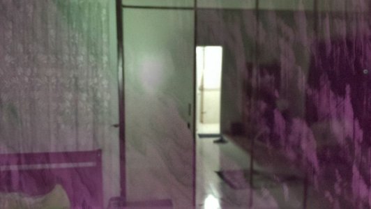

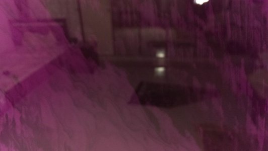

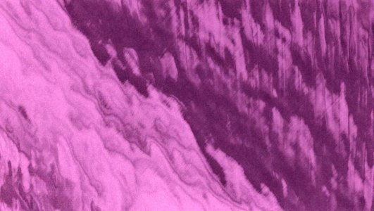

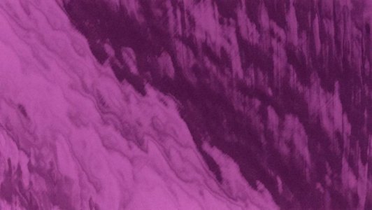

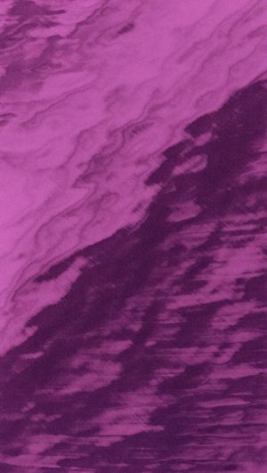

Hi:
I have the exact same problem with my HTC ONE. I had contacted HTC about it. They asked me to 1st do a soft reset of the phone (uncheck fast booting and restart phone) and 2nd do a hard reset (reset to factory setting). According to them if the problem was software based, this should solve the issue otherwise it is a hardware problem and you have to send phone for repair.
My issue was not resolved so as per HTC, it is hardware issue :-(. The problem for me is that although I bought the phone from US, I am living in Pakistan and now fedex-ing the phone to US for repair is a big pain.
Does anyone have any other clue as to how one can solve this issue.

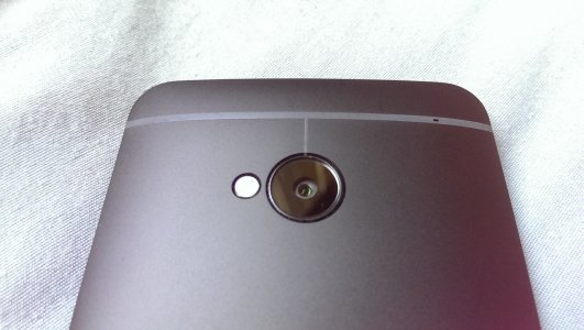

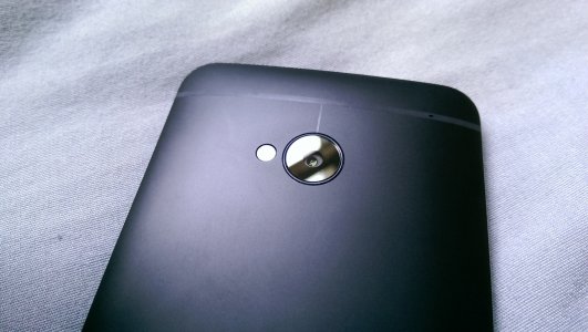

After a year or so I got fed up with the camera and decided to try to get the phone replaced through my carrier (AT&T) After talking to a couple tech support reps I finally got to one that knew what he was talking about and he confirmed that it was a hardware issue. He said that HTC just recently released something advising all carriers that the HTC one had camera issues and that the newer models would be fixed.

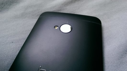

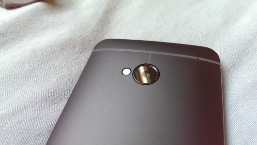

Below is a photo of my third device thats was sent out to me on 3/20/2014
Today a received a new phone in the mail 3/24/2014
as you can see the small bezel around the camera has changed and is more obvious instead of the flush look the older cameras had.
You can also see the difference in quality in the pictures.
Im happy with the new camera and am looking forward to taking pictures now even though I just ordered the Samsung Galaxy S5.
So if you are experiencing problems with your camera the software update might help a little but the source is the actual hardware design itself.
Just give you carrier a call and your phone should be covered under the manufacturers warranty still.
