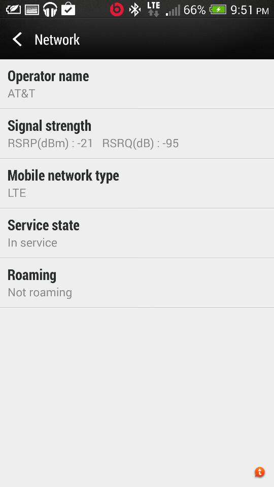

Re: Developer Edition LTE signal strength weak on AT&T
obviously good signal, but yeah very innacurate, I have proper apn and lte auto
