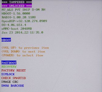

Here's a screen grab of my bootloader if that helps any

Make sure you have the most up to date recovery. I recommend switching to TWRP to see if that helps.
Thanks so much man. I was lost in what to do until you suggested to to flash the rom and get the newest one.
Phone is up and running finally with no issues!:)
