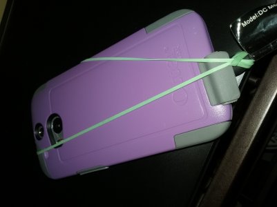

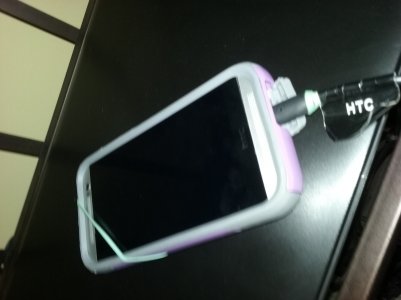

I just put a rubber band on the charging cord and onto my phone. Creates enough pressure on the USB connection to stay connected and charge the phone.20151230_184713.jpg20151230_184655.jpg
