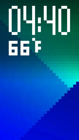

is this the same "magnet" issue that you are talking about? This is now my wake screen when coming out of sleep and hitting the power button. Using the Smart Launcher Pro with my HTC One M8 Android (Verizon).
Thanks.
