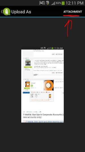

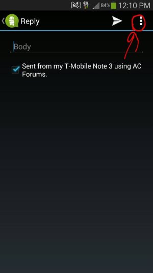

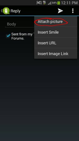

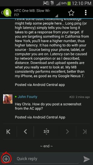

Hey Chris. How do you post a screenshot from the AC app?
Follow the steps below. You then just select your picture and there ya go :).
Sent from my T-Mobile Note 3 using AC Forums.
