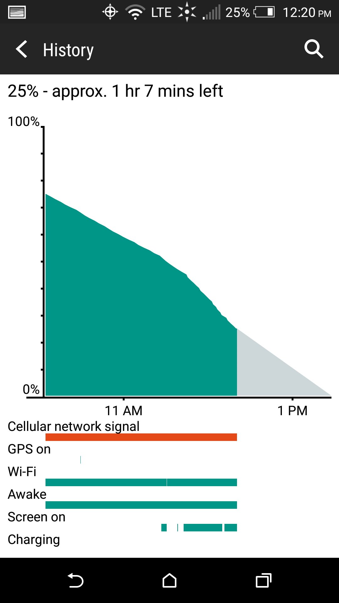

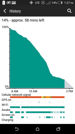

Recently, my phone has started getting hot, and the battery dies very quickly. Where it used to give me 12-14 hours of life before getting to the 15% low battery warning. Now, today, I was at 15% after only 5 hours! And it gets hot. But it doesn't seem to do it every day, only about 1/2 of the time.

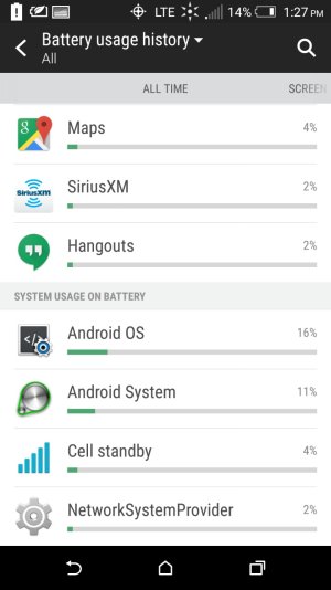

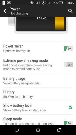

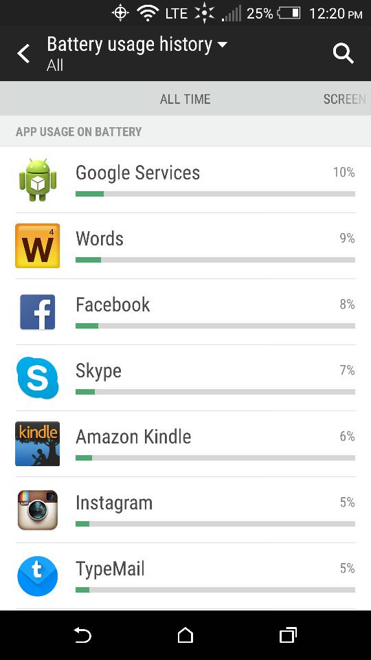

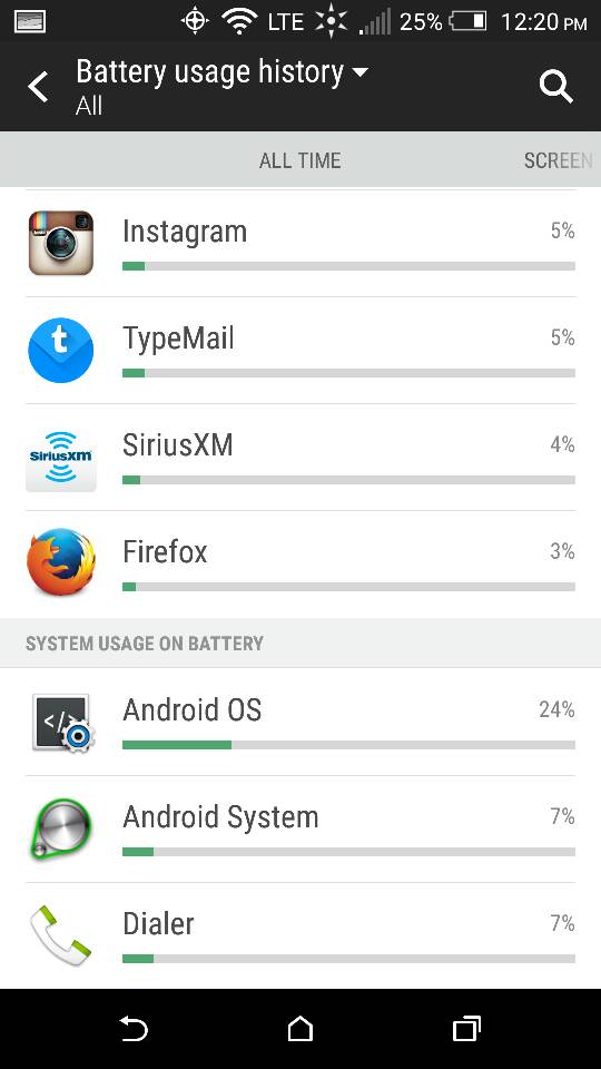

An update. It still gets hot and the battery dies quickly one or twice a week, but not always. I'll post screens hots of the power tabs, but I didn't see any apps really draining the battery. Right now it feels hot, it's been off the charger fully charged for 4 hours of normal use, and has 19% remaining. Usually a full charge lasts 14 hours or so.
I do see your cell reception in red for the most part, which means that will drain the battery a lot faster as it is constantly searching.
