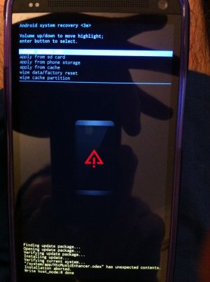

As i press install, the phone goes into shut down mode, where shortly after a symbol of a phone with a yellowish green 'sync' circle with a downwards arrow appears in the middle. Then you see a progress bar starting to rise, it gets to about 1/3 way and it slows down, it climbs 1 or 2 more notches then BAM, the 'sync' circle with the downwards arrow changes to a red triangle with an exclamation mark inside. The progress bar disappears and after a while nothing happens until i force shut down the phone with the power button. When it wakes, it still shows 4.3.
I did some search on the net to see if anyone had this problem and there seems to be similar results but are still different to mine, their fixes don't apply to me.
On the red triangle screen, i press Volume + and Power button together to get the boot log info, and here is what it says at the error screen:
*Note: the highlighted line reads "reboot system now"*
My error has something to do with that HTC Music Enhancer :S whatever that is.. Beats error? lol
I tried to "apply from phone storage" and from "cache" like the other forums stated but all fail to proceed with the update. The next message would come up as 'failed to check cid' or something and the phone just resets, only to leave me with 4.3 still. I also tried to go Apps/All/Updater -> Force stop + Clear data/cache but did not help my error.
I tried to reset my phone to factory settings twice and retried updating and nada.
I just picked up this handset today so i'm contemplating just going back to them for either another one or a fix on the spot if they can help.
Has anyone got a clue as to what else i can do at this point? Thanks.
