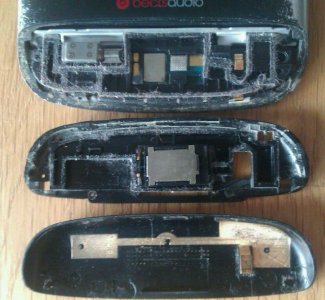

I managed to solve this following Jose Romero's suggestion.
I removed the lower back cover (which is sealed with a bit of adhesive, be careful).
There are two golden pads on the phone board that are connected by a third one on the plastic cover when it is closed. I think HTC uses that to detect that the cover is not present and hence there is no speaker.
Unfortunately when this happens, the whole audio sub-system seems to be disabled, which sucks ***.
Anyway, I soldered a tiny copper cable between the two plates and sound came back.
I also broke accidentally one of the pads of the speaker and had to solder it as well (trying to straighten them).
So as I said, be careful...

I removed the bottom cover of my ONE S (S3) which has two parts as it seams.
See my picture; top - phone, middle - inner part with speaker, bottom - outer cover.
Can anyone tell me which are the two 'golden pads' to be connected/shortcut??
Many thanks !!!

Maybe quite late for an answer, but for me it helped to clean contacts. When you look at the backside of your htc you see, that there is a cover on the bottom end as well. Just above the speaker. You can pry the lid open carefully (see youtube videos on the subject) then inside the lid is a copper inlay which makes contact for the speaker. This is oxidating over time (a bit) and the connection does not work properly. Just clean it with some small glass brush or similar. You can see where it should make contact. This worked for me and the speaker works perfect.
