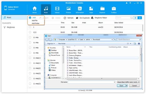

If you are having this problem, maybe it is because there is something wrong with the HTC Sync Manager app. You can try uninstall the app and then download and install the latest version. If that does not work, maybe you can try an alternative - Android Data Transfer that can transfer and sync almost everything on not only HTC phone but also all mainstream Android devices.
