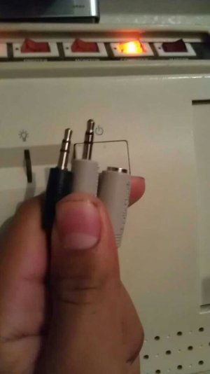

They tend to use a fatter (wider) headphone jack, like, look at the picture. On the left, that black cable is a 3.5 mm to a 3.5 mm cable, and it won't work because its too narrow for the Vivid. However, if I plug that black cable into the gray cable on the right, which is a 3.5 mm male to a 3.5 mm female, and plug in the gray cable's 3.5 mm male connector, it works just fine.
