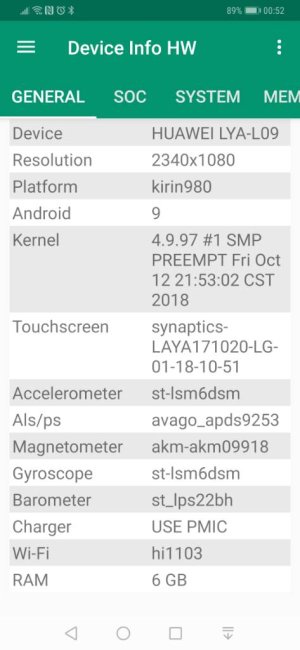

Has anyone checked their device yet? There's a app on the play store called Hw device info that you can use to see which screen supplier your phone has. Many of them that do show the green bleeding get much worse over time. This is a bigger issue for us in the US that import it because there is no way to get warranty support.
Here is a link to the app you can use to check your screen:
https://play.google.com/store/apps/details?id=com.mate20pro

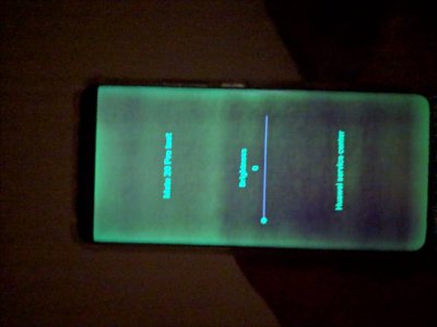

It's a gray background. Slide the brightness down to close to zero in a very dark room and if yours is affected you will see the green like on mine. Hope this helps. Thanks.

Post #1332 seems to have the solution - cure the screen with UV light until it stops (maybe half an hour).

Maybe? That seems like a weird thing to do. Maybe they rushed the devices out? If it's that easy of a fix surely they wouldn't be replacing devices over it.
It makes a little sense tbh. When you bond the outer glass to the digitiser they use UV light to cure the bonding agent. Same when you buy replacement glass kits on ebay for phones, they supply a UV torch to do it yourself. Maybe the LG screens have left the factory not being cured long enough and someone has discovered it themselves at home. Definitely worth a try for users in the US with issues as it's a lot easier than paying out.
