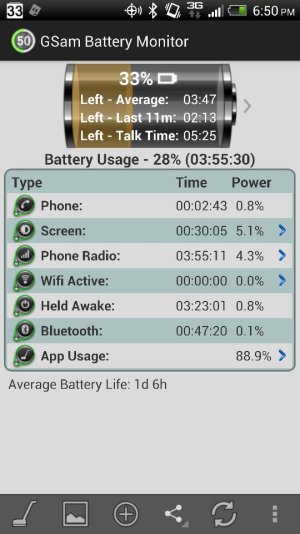

Started yesterday I have horrible battery life and I never used nova. GSam doesn't say anything besides held awake
I rebooted this morning when I saw I was at 80% and barely used it
