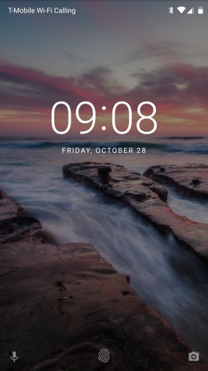

You'll know it's enabled if your lockscreen or notification shade says Wifi Calling. It works for me on T-Mobile but I had to re-register my e911 address with the carrier for some reason and reboot. The problem must be on Verizon's end.

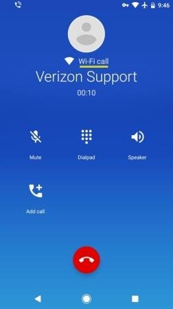

Verizon doesn't have a lockscreen notification for Wi-Fi calling. And therein lies the problem. Wi-Fi calling is poorly supported, and even worse in its clarity of use. I know I have activated Wi-Fi calling because I can make normal calls when in airplane mode and on Wi-Fi. You can see in the screen shot it says, "Wi-Fi Call" in the Phone App and that's the only way you would know. If you were in any other screen you wouldn't know because there is no icon in the notification area. There is no way to know if you've successfully enabled Wi-Fi Calling either.
